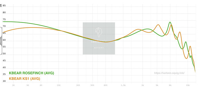

I got my set of KBear Rosefinch in.

That graph makes KZ looks neutral. :rofl:
I KNOW, DUDE!!!
I double checked Ian Fann’s graph when the package came and that bass is real. And I just heard the KS1 and Robin from KBear and was like “NOPE, hard pass!” And figured this would be another one.
I’m literally still on hour 1 of listening. But I swear to God, I didn’t put them in and want to chuck them out the window.
I have theories about this: There are three problem spots that make KS1 not really listenable. 1). The sub-bass rolloff is a killer for a BASS set. Full stop. 2). The steep pinna gain doesn’t allow enough time for the upper-mids to contrast with the bass. So there is energy there but it’s squeezed tight and the mid-bass still overwhelms everything. 3). The second rise into 5k precedes a cut of 5-8k, which murders the clarity for my ear.
Rosefinch has ALL the sub-bass, so it’s correct in the lower range, has a more gradual pinna gain into nearly 4k, and smoother through the upper-mids and into the presence area. It’s unapologetically unrefined, but it’s actually proficient at what it’s TRYING to do (so far).
