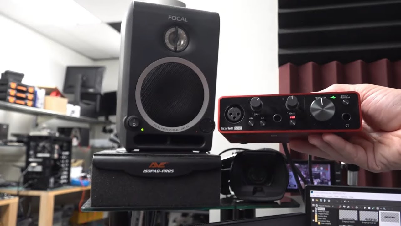

TL;DR Balanced solved an EMI problem from the USB connection.
Oh… it pains to listen his voice…
I bet he just failed with the cables from the start and did not even read the device manuals that clearly shows the fumble he did and then claims its a device issue…?
It’s like those 101 things for… those who need them.
If you have balanced Input (any device) and balanced output (any device) use a balanced cable…
If you have unbalanced input (any device) and unbalanced output (any device) use a unbalanced cable…
It’s not that hard.
Also don’t mix the two cause it’s just dumm and might have issues like this vpooper.
Dave is not just any guy.
His Rode AI-1 (Audiointerface) has been acting up on the software side, was fine on the EMI front though. Fine in the sense that it had audio ground and USB-ground decoupled making single ended work just fine.
The replacement Scarlett Solo couples USB-Ground to Audioground causing the issues described in the video when running single ended.
His channel is somewhat small, yeah…
I would like to trade place with Dave. He is highly regarded in the electronic industry.
I really do not care how many subscribers or followers the “guy” has if things like this happen. lol
Dont be this guy. lol
His Rode AI-1 (Audiointerface) had something mentioned as ¼” impedance balanced outputs.
"impedance balanced, allows the rejection of external noise by ensuring any electrical interference is induced equally in hot and cold signal legs.
This allows the common mode rejection characteristics of a balanced input stage to reject these common mode signals and hence maintain the audio fidelity of the signal."
So when moving / changing to a normal “balanced or unbalanced” connections / gear.
(so the man guy did know this, right?)
He should use a proper cable more suitable for the job. :wink: (not the wrong one or not blame the gear)
He’s right about the audio. Playing same time from both outputs but it’s also by design. Blame gear again?
Have connected many Scarlett devices for audio usage with USB and unbalanced connections to speakers. Guess what? Not one single error or disturbances in audio. It’s clean.
101 use right cables with right gear, ones again.
