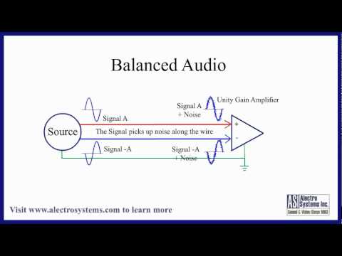

All electrical circuits – and especially AC circuits – both create and have to handle noise in some fashion. Here “noise” just means part of the electrical signal that shouldn’t be there. Sources of undesirable noise can be internal and result from circuit elements interacting with each other, or they can be external due to electromagnetic interference or dirty/inconsistent power. Balanced electrical circuits are very good at handling external sources of noise. SE circuits inherently generate less internal noise. Balanced circuits separate grounding lines from signal lines and therefore are not nearly as susceptible to ground loops or external EM interference like radio signals. Professional audio uses balanced almost everywhere because cable runs are often long – increasing the likelihood of picking up EM interference – and cabling also gets crossed and tangled a lot which means they can electrically interfere with each other more. Home audio applications often use short cable runs and it’s more feasible to manage cabling (if you want, lol). The trade-off is balanced amps and DACs will generate more internal noise because their construction requires nearly double the component count compared to SE amps or DACs. Here “component” refers to all the individual circuit elements such as resistors, capacitors, inductors, transistors, etc. Thus, “component count” means the total number of those things in the amp or DAC. Since a balanced design requires essentially double the number of parts as a SE design, it will generate about twice the amount of noise – raising the noise floor. But, if there is a source of troublesome external noise somewhere, an SE design will be far less equipped to handle it and the noise will often be audible.

Wonderful video for the science behind balanced and single ended interconnects. Mind you, balanced headphones do not have the noise cancelling effects from the amplifier.
