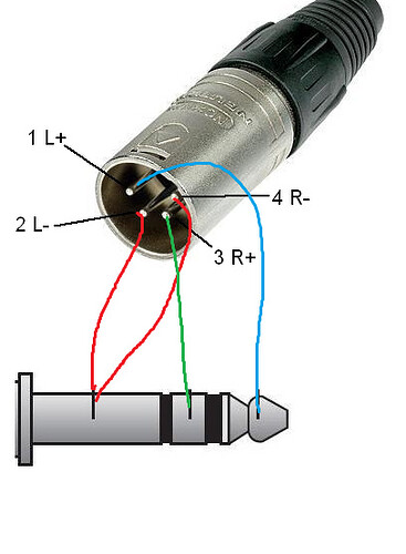

Like @Davidibiza said, you can’t just tie balanced (L+, R+, L-, R-) into balanced (L, R, Gnd).
I have no way to test it, AFAIK you would need resistors between all of the pins to take up the difference in bias level from the amp.
What you can do is build a “unbalanced to balanced” adapter. That ONLY is to be used from an unbalanced out to a balanced headphone.
In a blanced signal, one signal is the inverse (or 180° shift) compared to the other. Both have the same voltage to ground, and double that to each other
When the unbalanced output is more of an afterthought, then just one of the signals is fed out the front resulting in “half” the voltage. As Power is Volts times Amps, half the voltage results in half the power.
You can achieve the same power at out of single ended as you can out of balanced. Just have to do the engineering for it.
