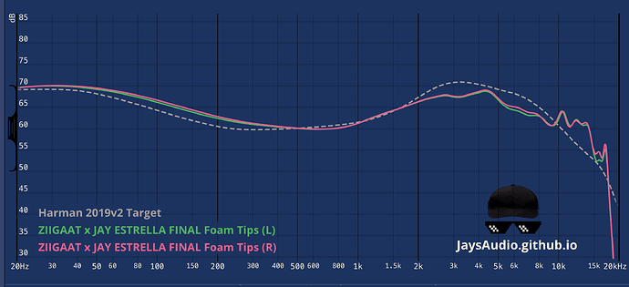

On the Doscincos I found upper mids a bit too prominent and bordering on honky, even if I wouldn’t expect it from their graph. Are upper mids even more pronounced on the Estrella? (By ear)
Honky? That would be because there’s too much low-end + no treble/air emphasis, look at that mid-bass. Estrella has less, it’s not honky to my ears ![]()
The 4.5kHz peak is interesting. Was that a deliberate tuning choice or more like a side effect of achieving some other tuning goal?
Deliberate. Since the 3K is pulled back you need something later or else the vocals won’t sound as good
You get enough of the vocal details without it becoming shouty in the uppermids like Harman ![]()
That’s such a smart decision. That 3k area is an issue for lots of folks, me included, so seeing a flatter, more gradual rise with a small bump for clarity way after has me excited.

3k affects timbre for me usually so I welcome this tuning. Looks like a better Kailua!

I found the Cadenza 4s to be too bass light and a little thin in the noteweight, kinda sharp sometimes. It has a clean harmanish tuning, whereas Estrella is very different - dynamic with contrast.
I agree with your assessment of Cadenza4. A bit thin but it makes it very versatile. But I’m looking at something with more bass so…
What area in the frequency response do you attribute more dynamic sounding set over a less one? Implementation being equal, and does a dynamic driver make it a more dynamic sounding tuning over non-dd?
If we don’t include the actual dynamics in a song/recording, and just graph wise, it’s not a specific area, but more like how the whole FR is in relation to one another. For example, a straight line would be dead neutral with no “contrast or dynamics” to the sound since there’s no change to the FR for contrast to happen, because well, it’s a straight line. Whereas having some change in elevation or dips creates a bigger difference.
The bigger the difference the more “dynamic or contrasting” the sound is, but you’ll also need to strike a fine line between changing too much and creating big peaks and dips that’s not only very shouty and sharp, but also creates masking and hides the areas that it shadows.
So tldr, for dynamics you want some changes in the FR (like small peaks and stuff), but not too much to a point that it’s overly done. The Strom would be an example of dynamics done right (ignore the 8K that’s a measurement thing), and the FIVE would be an example of what NOT to do:
