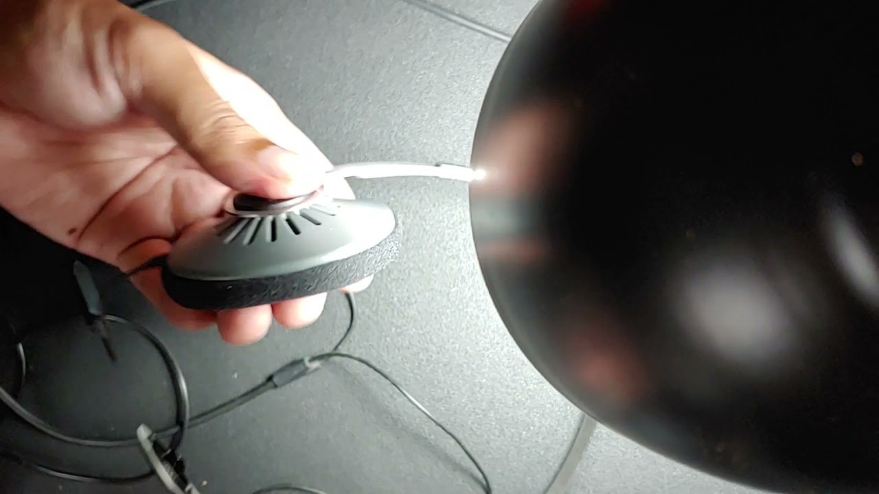

I had to do a repair for a MMCX connector that came loose, so I decided to try some damping mods to help tame the high end sizzle I have when using the Grado pads, and see if I could get more low end.
I had some transpore surgical tape (readily available on Amazon) left over from my Fostex modding days and used it to cover the vent holes in the cup from the inside. The nice thing about the transpore tape is that it is covered in tiny holes, so it does not completely block all airflow, it just dampens it. Along with the tape I have the stock cup foam inserts.
With just the addition of the tape I did notice a small bump in the low end, so with that I went to work on trying to ā€œtuneā€ the driver.
I cut small strips of the transpore tape and covered up different sections of the front of the driver to see how the sound was affected. I finally landed on the following configuration…
The photo is of the left driver. I have found that tape placement front to back, top to bottom, can affect the sound a fair amount thanks to ear shape (most likely), so keep that in mind.
With the tape on the driver the sizzle is gone, but the highs that I do want are all still there. With that high end noise tamed the low end has opened up a bit more as well. I really like the much more balanced sound, and the soundstage/imaging are still just as great as before.
I will run them like this for a while, but may do a little more fine tuning later.
I have the new Dekoni Porta Pro pads coming in tomorrow for my KPH40’s, so once I test the new pads I might try a little fine tuning with the tape on those as well.
If you have any questions just let me know.
