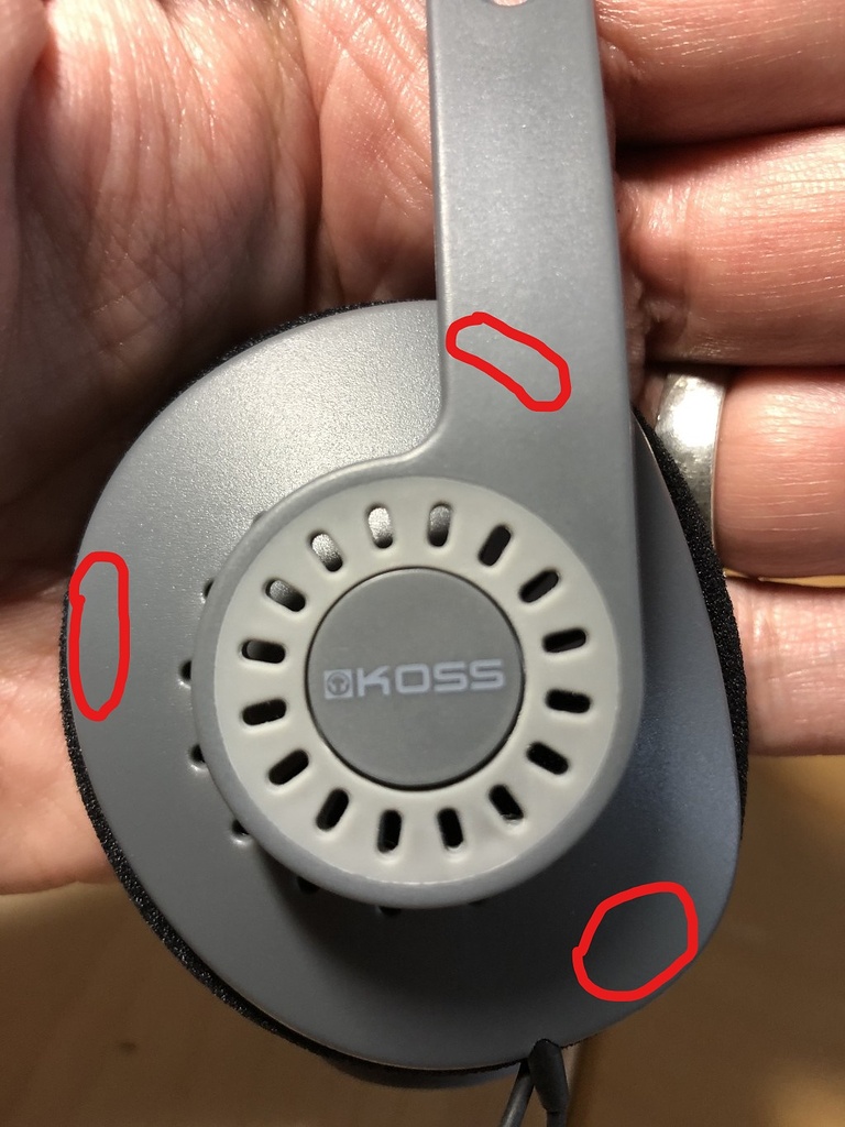

OMG I accidentally found this visual guide specifically to replace (and keep) the KPH30i’s stock foam pads into Yaxi pads:

Ah yes. What I did was I gently pulled the foam off them, then as the tabs began to show, took a pair of pliers and ever so gently popped out the driver and the housing. Popping them back in is pretty simple, and this is certainly a good way to do a pad change without going through the entire re-wiring and soldering process.

I’d like to share this guide which allowed me to keep the stock pads and safely opened the 30i without breaking the clips, bent some of the teeth though. Took me a bit of finesse and a guitar pick just so I can still go back to the stock pads or even try on some future pad mod like this Grado G-cush mod for kph30i.
