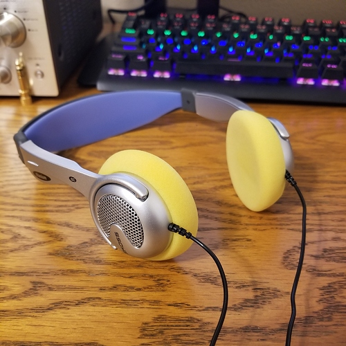

psst KTXPRO1. Fit is shit, but it’s a KSC75 with some more bass :^)
I’m getting a Pro4AA in the retro bundle, so it will be interesting how I’ll feel about it. As much as Zeos hates them, seems some people really like them, but still inferior to vintage ProAAA’s.
I will take a look at them, looks like the typical yaxi pads will fit them as well so should work out. Not sure how I feel on the headband though, less you can actually change the headband
Headband is similar to KPH30i. Even the shortest setting is too big for me, but I do have a small, roundish head.
The big issue is the stock pads may as well not exist, but Yaxis ruin the soundstage and tonality for me. It’s interesting.
hmm, that’s rather unfortunate. Wonder if theres a good pad replacement then that won’t kill the sound. Nah, I would just remove that blue strap and make a custom one for it if anything as far as comfort goes
 I have a large head though so, should fit
Maybe foam plantronics or pleather doughnuts. I didn’t experiment much. I settled with My unused Porta Pro stock cushions, which are I kid you not twice as thick as stock KTX cushions. Tolerable enough for me.

Just look at these. I wanted to love them but I couldn’t :cry:
I could probably try some like grado pads on them, they can fit the ksc75 decently well.
I believe the portapro has thicker cushion than the ksc75 doesn’t it?
PP uses a softer foam, but size is same. I wonder if the scratchier KSC75 foams are more less treble dampening tham Porta Pro cushions. Now I’m curious.
worth looking at, foam density does seem to alter treble
edit: just saw the picture, oh my that’s beautiful.
