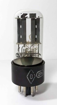

Definitely time to get a Darkvoice 336se with a set of cheap swapped tubes. One of the best pairings with the 6XX in that price range.
I saw someone recommend the TA-10 I’d definitely reocmmend the Darkvoice over it but I get the bang for the buck on that DAC Amp combo maybe too much to resist. If you end up getting it Definitely switch grab this E80CC tube it sounds incredible with the amp
