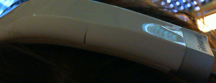

Had a bit of an incident last evening/night:
With a sharp crack, the plastic of the top-shell of the headband developed a crack.
Looking online, there seems to be a 1/4 chance for this to happen. Link to some Amazon.de Review, same issue
RMA inquiry with the shop was replied to (including a shipping label) in less than an hour. Big kudos to MD-Sound.de for that!

And all would be well, except for a flaw in the headband design or material (or both).
The replacement I got cracked in the same exact spot in the same exact manner.
This cracking is caused by the design. You see, a U-profile is very good at resisting forces in all directions. The head-facing part of the headband is flat, so it just conforms. The upside down U-shaped plastic forming the top half reaches stress limits and cracks.
If the headband was made from thin spring steel (think Porta Pro headband), then this would not be an issue as steel does not just snap like plastic does (under these forces at least :wink: ).

Why I am not sending it in for RMA a second time.
I paid 44.50€ including shipping for these. The postal services are overworked anyway due to human malware. Yes, there is a crack that shows when I put them on.
I don’t care about that one crack. Gives it character, I guess. :man_shrugging:
