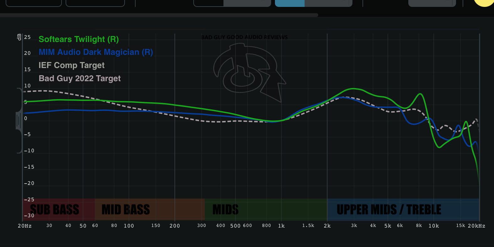

Someone here compared the original Dark Magician against Softears Twilight?
Probs but they ain’t graphing like brothers…
