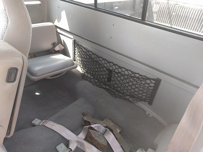

That’s the kinda space you’re working with(this is with the seats pushed all the way forward with the driver seat leaned all the way forward), only right behind the driver’s seat. It’s about enough for a child to sit there, only the side folding jump seat behind the driver’s seat won’t be getting used. If anything the speaker behind the driver’s seat is closest the my ears then the one on the driver’s door.

If we’re going into things outside the budget, please don’t. I’d still like to be able to use the other part of the space in the back of my truck.

you have room back there for dual 10" in a slim cab. point them at the back of your truck, not towards you. you want subs reflecting in cars before they get absorbed by the interior. @Etroze86 is 100% right about seats absorbing bass response. they will eat it up.
do you need to use the back seats ever?
edit: thats the 12" version of that kicker combo i linked. they also make a smaller 10" version. not sure your exact measured room back there.

Yes. Yes I do. I’ve had a passenger in the back seat behind the passenger seat on multiple occasions. Once I’ve secured a tool box for the bed, I’ll have all the tools currently living in the back in the locked box instead of taking up that space.
Edit: the only back seat I don’t plan on using is the one behind the driver’s seat
