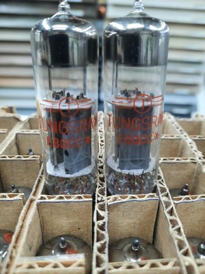

Strongly recommend for the bottlehead these three tubes:
A lot of people in the crack community like the RCA clear top
These are mind blowing [E80CC’s fit in 12AU7 sockets and they’re so sweet]
The old Svetlana for that mid range magic. Cheap and outstanding performance.

Oh man, thank you so much for the tube recommendations. I’m a total noob when it comes to that stuff. The only tubes I’ve messed with are the ones in my guitar amp. I’m surprised you said the Elex would sound good. I was under the impression only high impedance headphones work well with full on tube amps. I’m thinking about going up a tier and getting the Clears instead. Do you think they would play well with the Crack? Regardless, I’m super excited to build a Crack, get some of these tubes, and plug my Sennheiser into it! Thanks so much!
Hey no worries anytime I’m tube obsessed they really are magic. The elex does… Sound rather bloated in the bass it just fun to hear the added bass bump. Either Elex or clear are excellent.
