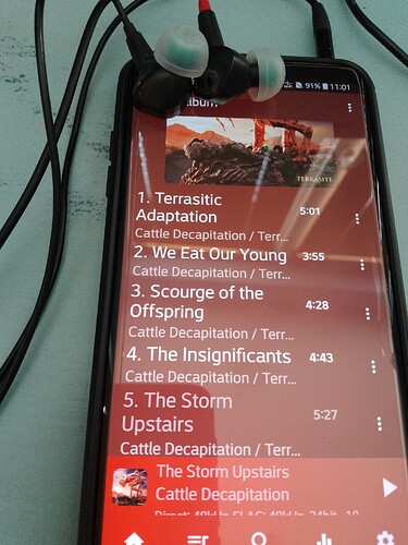

On the subject of the different color IEM/buds shells making for a different sound: I painted my IE600 shells black today and got a big difference in FR:
Let me guess, they sound a lot darker now!?
Yes, but with preserved resolution, a slightly larger soundstage and a little less fatigue from listening! ![]()
In fact, it is surprising that with darker sound the resolution is preserved and even slightly better (I know the price difference)! ![]()
Damn your description is on point, you are hired for promoting new releases on head-fi ![]()
I have long wanted to become a presenter at Head-Fi, it is my childhood dream. ![]()
But no joke, it’s the truth. Blacks are inferior to grays only in terms of dynamics and a slightly closed sound (some call it dark).
