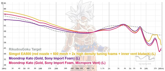

Heard u guys wanted mods? Here you go.
![graph - 2023-04-20T193334.658|690x298](upload://bBcMEBlnxDP6cusc0n4npW
TQbQD.jpeg)
Man this’s getting confusing lol.. and I thought this was bad :grinning_face_with_smiling_eyes:
lol, what is confusing u? Im literally just naming it after the recipe. :rofl:
It’s labeled well, I think it’s just the number of variants present!
Wow, you managed to get the bass levels up to Legato levels! How do they compare in terms of sound?
Legato bass is MUUUUUUUUUUUUCH bassier than that version of the EA500, heck I dont find it THAT bassy actually. Speed and tightness doesnt degrade too much compared to stock EA500. Its definitely not a substitute for a basshead iem imo.
Another example of how the FR only tells a part of the story!
Looking forward to your review!
Will only make a short impression post on it. Give it a day or 2.
how does that elevated bass sound to you @Rikudou_Goku ?
EDIT: Just saw your comments above!
@GooberBM dude, I swear your pair has a similar FR to the Legato now that I’m seeing the graph here.
I put a high density tuning foam and then low density foam into the red nozzles, with a 450 filter paper on the bass port…so it’s pretty close to what Riku did. Just not the extra mesh
That 450 damper on the vent wont be as drastic as mine though. Since mine was with a 100% seal (blutack).
Definitely. I was adding bass while still maintains good balance with the upper end. I wasn’t going for basshead attempt

I should mention that if u thought about reducing bass via blocking the outer vent, it doesnt do anything.
