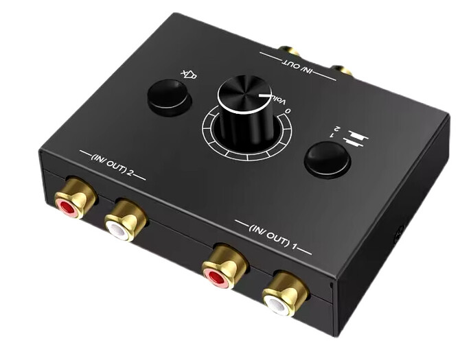

Does this setup look correct?
Basically, if I use a switch
That connects to the preamp (RCA) on my Asgard 3 then output via RCA either to the M10 Plus OR a Y splitter RCA like this
Then one end of the Y splitter to the Swan OS-10 and the other end to an active sub, such as this
Would that work? That is, can I simply switch between the Swan M10 Plus and the Swan OS-10+Sub combo? (when the JDS Switch is switched to the Asgard 3 amp.)
That should work just fine AFAIK, as long as the sub sees the ~2 VRMS (which it should from the Y-split) then you’re good. Worst case scenario, maybe have to turn up the sub a lil’ bit if the signal from the Y-split is a little weaker than a straight connection, the RCA Y-split is a classic method of integrating a sub off a preamp with no dedicated variable output. Are you going to use the Ali switch as your volume control, or max that and use the Asgard 3? Either one works tbh.
Honestly the most convenient way to control volume for me is to just adjust the windows volume (or Linux in my case) and have the preamp via my asgard 3 (and jds atom) on max volume including the switches. The speakers arent at max though.
I hope not hahaha (well, not without another source controlling the input gain anyway).
Haha yeah, volume control via OS can be poor in terms of how linear it is. In windows iirc, every step is ±2%. With Linux I at least have ±1%. its convenient since I have a volume wheel very close by. I got this for that purpose.
