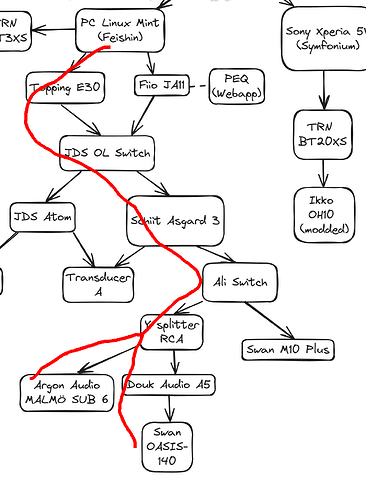

Depends on your setup. If you’re running it to active speakers, then you’d run [pre/DAC] to the sub and then into the monitors, using the sub for the high-pass and low-pass. If you’re running the separate [pre/DAC] and [amplifier], then you could run the [pre/DAC] to the sub for the high-pass (which is limited to 80hz and up) and low-pass, then run the RCA or BAL from the sub into your [amplifier] which then feeds just the high-passed signal to the passive speakers. If you’re running the Douk Audio A5 you posted, then you can just run the Aux to the sub (to blend with the sub’s low-pass) and use the A5’s high-pass to feed your passive speakers.

So either this setup
or this.
