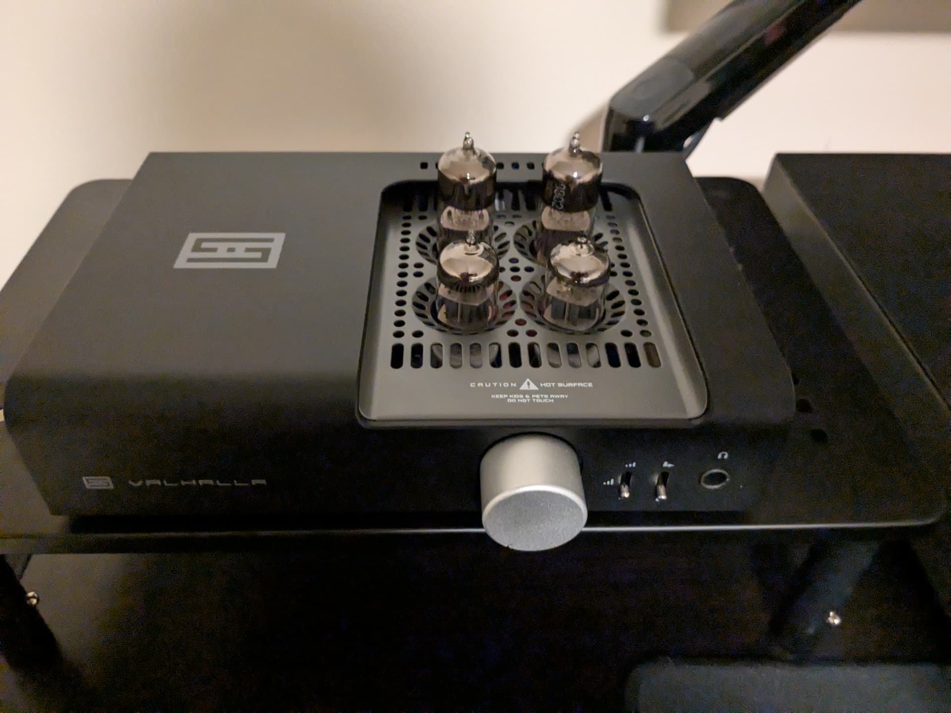

In other news, my NOS tubes arrived early for the Valhalla 3.
Edit: They just warmed up, and pair very well with my Atrium Open.
Lol that’s very fair.
6sn7s slot in or are you using adapters?
Socket savers & adapters to get it to fit.
Man I have some Phillips E80CCs that I wish I could adapt, I bet they would be great in an otl design.
One of the owners in another forum plans to roll the power tubes. I am curious how that will turn out.
Saw that, didn’t he say 2 adapters were needed?
I would have to reread the post, as I thought he was using a socket equivalent tube.
