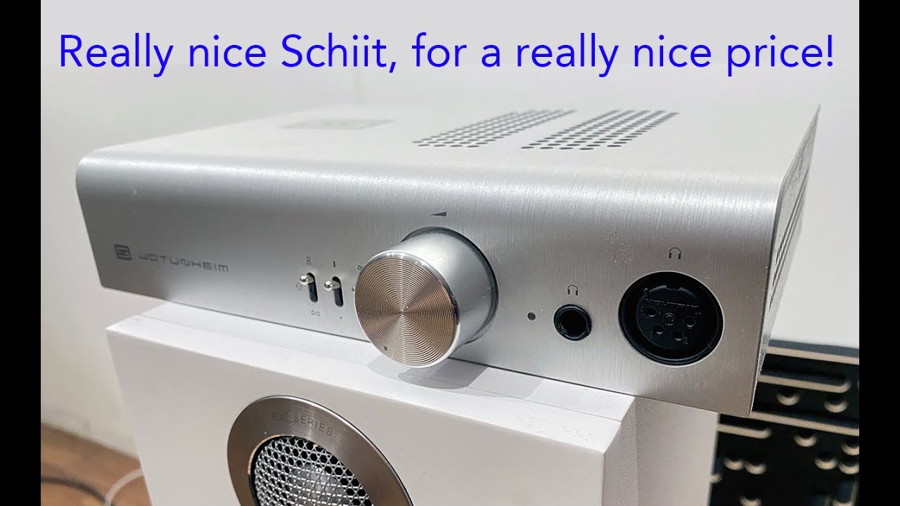

My Jot 2 volume knob issue/concern
Unpacking the Jot 2 and giving it that “look over” one does when holding and admiring a new piece of gear for the first time, I noticed the volume knob was sticky and not smooth. From the lowest setting, I’ll call it 6:30 through 8 o’clock was OK. But at 8 o’clock it started to stick and I could feel it “scraping” and also hear it too, like metal to metal, and it became very difficult to turn, hanging up pretty solidly at 9 o’clock. It was like that through about the 10:30 position where it then freed back up and rotated normally and without resistance or scraping noise.
I contacted support and described the concern as above.
Support response:
Please gently remove the knob and then push the knob back on being careful not to push the volume knob to close to the chassis that will cause friction.
I removed the knob at Schilt’s request and it was immediately obvious what the source of the scraping was, and it fit my description of symptoms and the range of movement where the scraping noise was heard, and where the knob ultimately hung up at.
You can see where the scraping was happening, from the anti-twist stud that protrudes from the chassis, as it was routing a groove in the knob (my metal-to-metal noise). Also, looking at that anti-twist stud that juts out of the front of the unit – note where that is … 9 o’clock, where it was hanging up solidly.
I replied back to support and sent them photos. We had a few more exchanges and ultimately, I was sent a replacement knob, another push-pull type. I was hoping for one of the types as used on my A3 that uses a set screw to hold it in position. I think one of that style not only provides more control over positioning but is also more secure.
Conclusion:
All in all, it’s wasn’t that big of a deal technically and Schiit did send a new knob. I’m sure it will be fine now knowing what the root cause appears to be, and that I am admittedly a very picky consumer.
Edits: I replaced where I wrote “screw-tip” with “anti-twist stud”
That is not a screw, that is the “anti-twist”-stud on the pot. On this picture, you can see it:
That describes precisely what I was experiencing as well.
