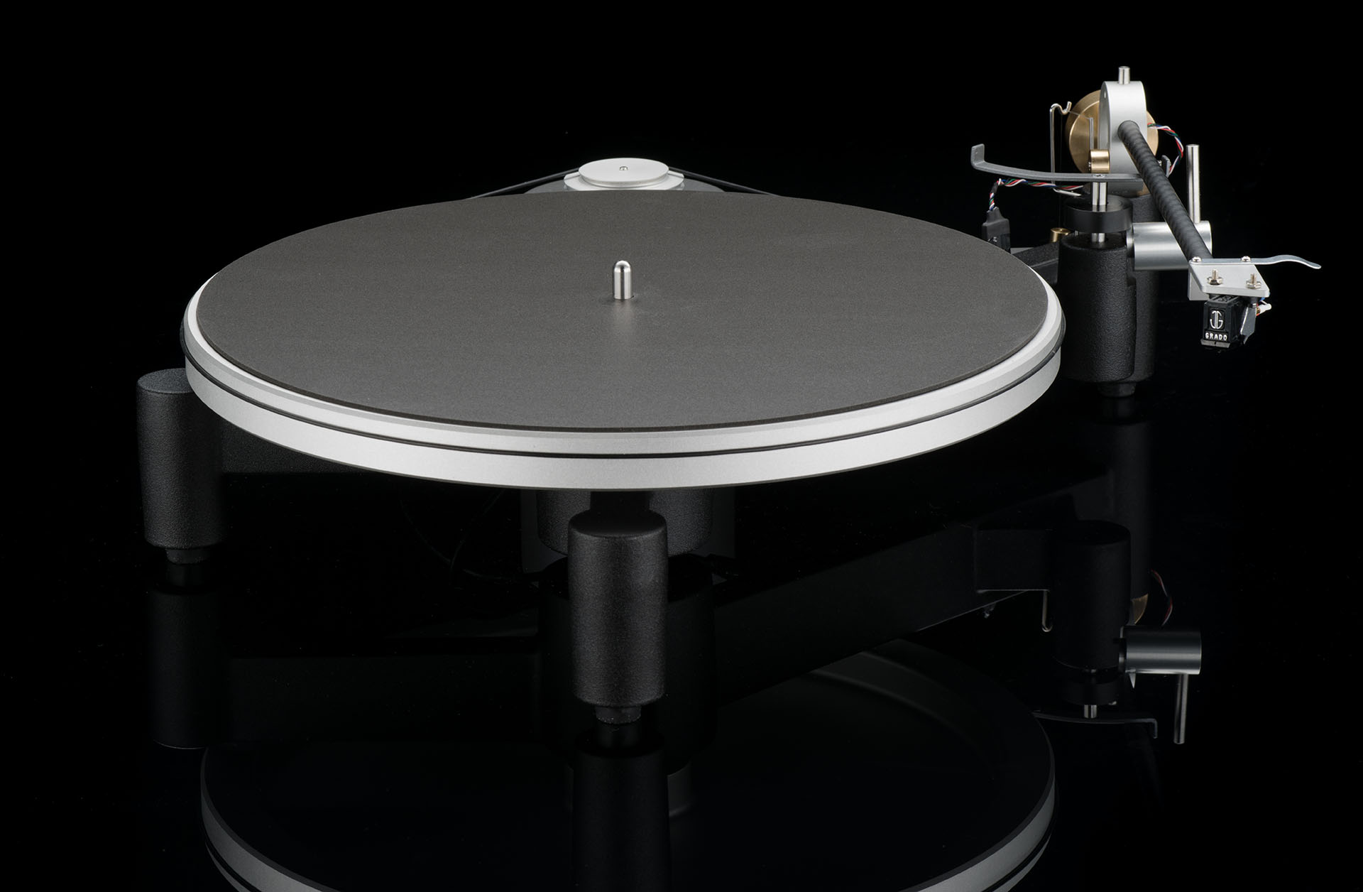

I am just now watching the setup video, I do have concerns about how much the tonearm wobbles around…
If it stayed in place, this would be a vertical lathe.
Your first visit to Schiits website?
Well, IMO, I like the adjustability, but I’m not sure of the advantage of that type of tonearm design? It looks cool, but I wonder if you would run into issues, given the ‘play’ it has in being able to rock back and forth that way. And just a basic impression comparing it to the Rega I have… the platter on the schiit seems to have more ‘wobble’ to it and the tone arm on the Rega doesn’t rotate/wobble like that at all… which I think would be preferred. The cueing lever is also a lot better on the Rega… as it has a slow delay and soft landing… unlike the Schiit which seems to rely on the user to slowly lower the lever carefully. And the fact that he had to push the platter, after turning it on, to get it rotating was a bit odd… lol…

Its called a Unipivot Tonearm. I personaly played arround with a 12" Clearaudio UNIFY and I think the disadvantages outweigh the benefits.
Pro: less friction, looks cool
Contra: needs a very very solid chassi - dampening it is impossible, a wobbly table or vibrations through the floor are deadly - work best screwed to the wall, very sensetive to resonances, horrible to setup, bends soft cantilever, wobbly / less stabel with uneven and especially exzenter records
If you have managed to set them correctly after ages they sound very good. But Unipivot is not a recipe for success, because as with any tonram, a lot can go wrong with the design.

A Unipivot tonearm always wobbles when you drop it, but with a good record it stays still when playing. But especially the combination with such a bad lift without damping is not a good idea.
With a belt drive TT it is always a good idea to handstart the platter before turning on the motor. Even with a lightweight Rega. But I the motor should still be able to do it on its own.

I just hate the strap around platter design. It only works decently with very heavy platters like Transrotor. Many people write about the shiit sol: the belt moves extremely at the platter and the motor assembly is too lightweight.
Why the shiit is shit: follow up…
Behind the cartridge there is hardly any space for the cables and they get squeezed. There is not enough space in front to adjust the cartridge properly.
I miss damping materials on the tonearm.
The antiskating is a joke and does not work properly.
How the cable is led out of the tonearm tube is absolutely stupid, because it pulls on the tonearm.
You would think shiit chooses a cartridge that is well suited for their tonearm but…
The Grado Reference Platinum2 actually comes with a wooden case to dampen vibrations. The only problem is that the 13g tonearm seems to flies out of the groove with a 10g 20µm/mN cartridge. They remove the wooden case to make the cartridge weigh only 5g like a Grado Prestige, to fix it.

I personally consider the shiit turntable simply unsuitable for beginners. It is too complicated to set up and requires a lot of expensive tools to do it correctly.
With a Unipivot tonearm the alligment is much more difficult and dangerous for the needle. I can well imagine how the newcomers get frustrated or destroy their beautiful records. Especially the video is just completely wrong and absolutely not the right way to get something decent out of this turntable.
This turntable is not for beginners!

I have a Sol beta and agree with most of what has been written here. Cueing needs work. It is not for beginners but they will be shipping with a factory cartridge fully setup. I’m very happy with it and plan to keep it. It is a modders dream if you are into such things. I like Conrad’s setup video best.
http://www.conradhoffman.com/Sol%20Support/Hardcore%20Sol%20Setup.mp4
Yeah, the setup does not seem all that intimidating, IMO. Definitely more involved than an average turntable, but the adjustability looks nice… for the price it’s hard to beat in terms of features… (But the Rega 2, I think is a better option at the same price point unless they work out the issues). I do enjoy tinkering with stuff like that. My main concern, as mentioned before… is how well does it track with the uni-pivot tonearm? Do you ever have issues with drops onto the record?
And I agree with @German_Power about the cable coming straight out the back with no bracing… and how it can affect the tone arm movement as well. I think that aspect needs to be rethought a bit as well.
I hope Schiit continues to work on it, but it definitely needs some rethinking. Even if they have to raise the price a bit, I think it would be worth it, if it lets them fix some of the issues. I’ll personally be keeping an eye on it.
All the same, very cool that you own one! It seems like a very fun turntable to play with. And it looks lovely, IMO =)
