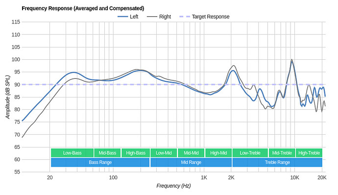

Graph comparing SR60e’s and old SR80e’s (yeah
 more of the same):
New, bassy (more neutral) grado SR80e’s:
Edit: Grado GW100s (wireless):
So they’re finally making more neutral stuff. My SR60s are way clearer and
 more painful, than my HD58Xs. This is definitely better.

Yeah, well, when it’s like a mountain at 2khz, another at 5khz and another at 10khz, you’ll obviously hear micro-details
 Grados are throwing them at your ears. :stuck_out_tongue:
HD58Xs already have impressive detail and have a perfect frequency response compared to SR60s
