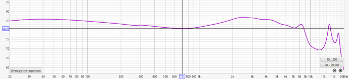

trying to balance as perfectly as possible, also remove peaks

Further refinement. Actually made a large change to the shell design. Someone told me the air factor is poor for the price im asking so..
Price factor aside trust your ear. Hasn’t been a let down on any of your retunes/mods. Your ear is the magic of Shortbus Audio. Trust it and go with the one you think sounds better.
This is a fully open back iem isnt it? In that case it would be fine for it to not graph with that much upper-treble, they still sound pretty damn airy due to being open back.
Nope. It’s not open back and in fact the opposite. An analog would be a ported high end speaker with a back volume transmission line for bass.
aaa ok then yeah maybe it does lack a bit of air there if going purely by the graph. But if this is meant to be for high volume use, you get your air via equal loudness curve anyway.
