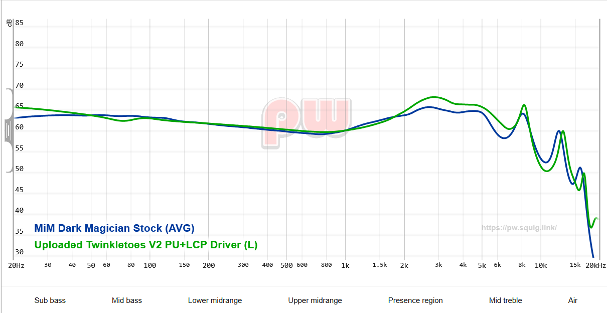

Back to IEMs. I had to do some testing to understand why sometimes these shells produce slightly different results.. which arnt really hearable but graph-able.

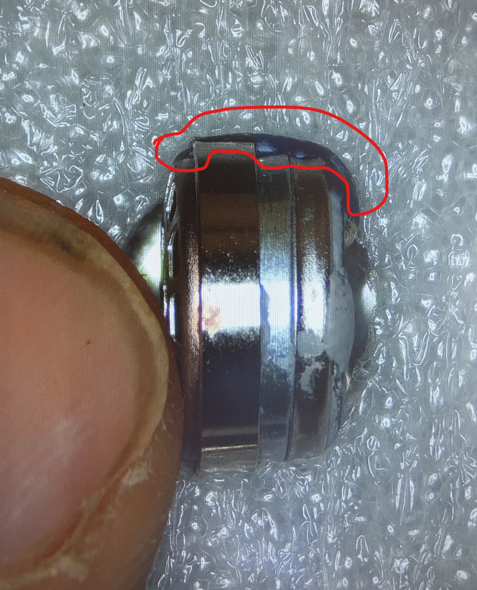

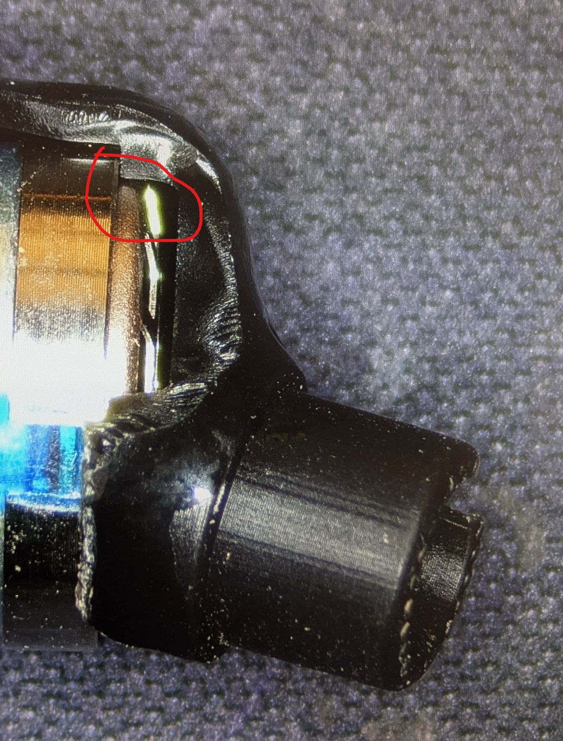

We can see here this gap is too much, the driver can shift by some tiny amount when building. This is not acceptable.
Deeming that not acceptable is something most brands wouldn’t do seeing how you can’t really hear it. But the fact you are is a testament to your craftsmanship IMO.
Thank you sir! I would accept nothing less myself and so, it must be fixed.
Another issue, some drivers are built like shit with too much glue for the wires leading to shell-mating issues. I will take this up with the manufacture.

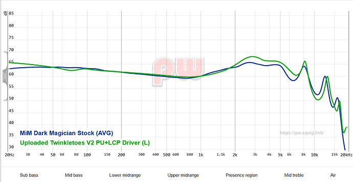

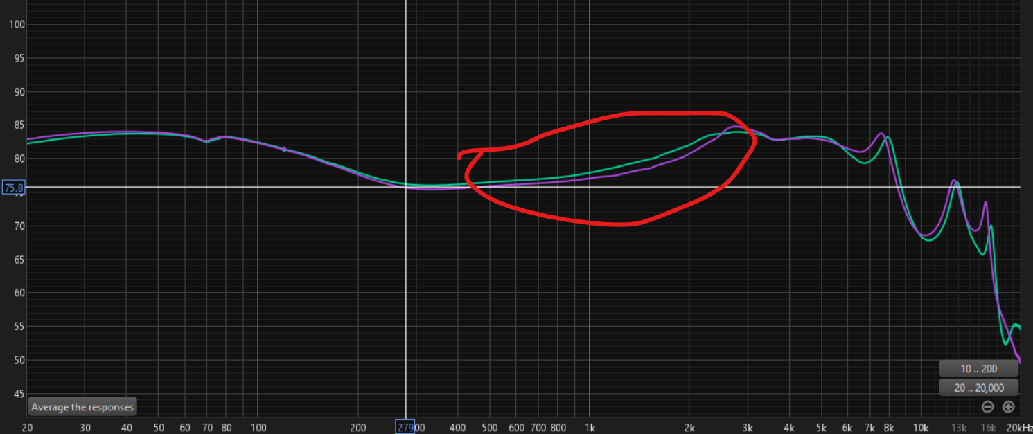

I have an actual important question that people might not be able to easily answer but here it is: 2 Graphs: These are 95% the same driver, the last 5% is the internal hemholtz chamber being different.
What do people prefer?
imo…
probably the green-ish one as it makes the peak around 3k less peaky by contrast.
HuaYunxin had the same problems, they ended up removing the glue all together that exposed the voice coil leads which became problematic for me since i couldn’t work on the back volume tuning.
As for the gap problem. You could add bracket/spacers that hold the DD in place and still have clearance for your tuning. If that’s a requirement for your design IMO
Also, if you are confident, you could take a blade and scrape some of the extra glue off, the voice coil wires should be well below that region to not get scraped by it.
IIRC those are expensive drivers right (the TT ones)? Bit disappointing that they deliver them like that.
Whichever presents itself as smoother sounding.

A little late to the party but I like the green graph.

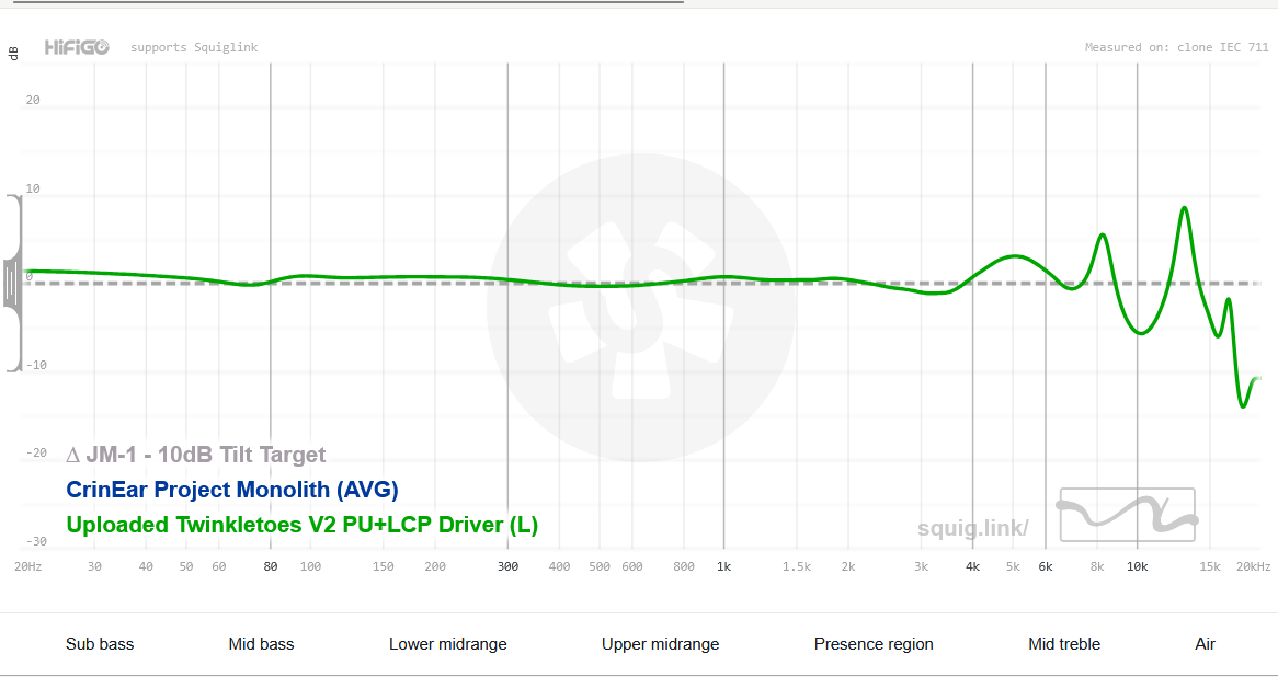

Sorry, I should have mentioned, but its the JM1 with -10db tilt compensation. Which means in theory this sounds nearly perfect.. lol.
Raw is this:
Got it :flexed_biceps: Almost full circle in a way with this getting so close to the DM.
Probably the purple line since I don’t like it if 1 to 2 kHz range is a bit shouty.
