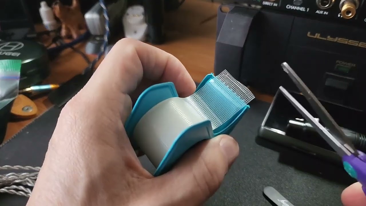

Extream version #2 Vent Mod with alcohol Swab & Transpore tape. There is no doubt this is it but dare I say too much. None of the vocals or Mid Bass effected so far in my test Tracks except tickles my ear hairs!
This mod is based off my experience using Dynaudio’s Variovent and my car audio compitition box design and builds. I put link below for the Dynaudio pdf.
Definitely more time consuming and here is the video.
Step 1:
Take a two layer alcohol swab and let it dry out.
Step 2:
Cut into a 2mm wide strip and tear in half the length to make 2 strips.
Step 3:
Roll strip after washing your hands you filthy animal, into a tight roll and taper the end.
Step 4:
Place rolled swab into vent hole and push down gently leaving a slight mushroom top.
Step 5:
Place 4mm x 4mm 3M Transpore tape over filled hole.
When and I you decide to remove the mod the filled hole material will also come out when you pull off Transpore tape.
ENJOY TDM🙏
