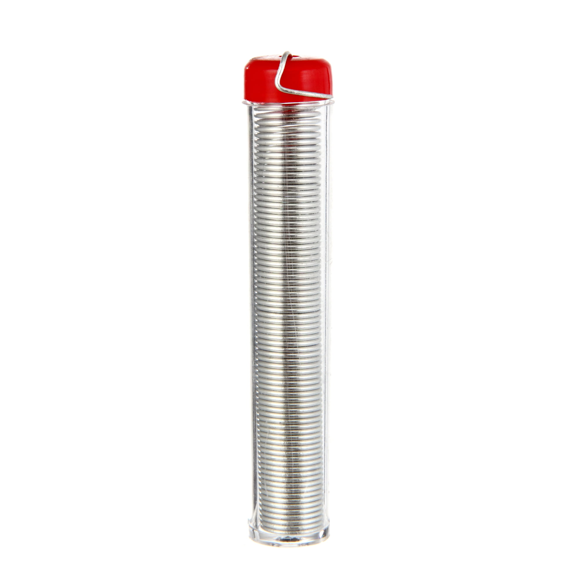

Solder? Ummm… That’s a no… And I do not know how much this is gonna matter, as what I could go to the store and just pick up is shit like this:
that hyper tough one should be fine. different brand but same shit i use. the rosin core is nice as it saves you a step pre-applying flux.

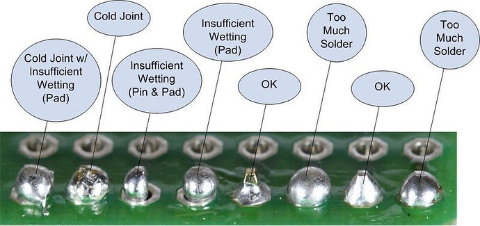

The joint
Hard to describe, here are some examples:

All the examples in images are good ones.
