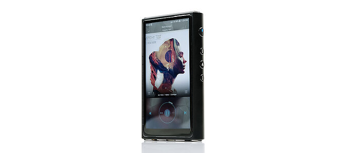

Third, I can return the Monoprice and invest in a mid-tier DAP, one that can also connect to PC. I’m looking at the FiiO M11 Pro when it comes out. But I have seen one comment saying the current M11 does not power Argons properly, not sure if the Pro can or cannot.

If you were concerned about power, you could look at the xduoo xd-05 plus and fiio m6 combo which would be cost effective and more powerful then the m11 and thx portable. Another combo could be your phone and a fiio q5s with a thx amp module if you still wanted a dac/amp not a dap. The m11 pro is also pretty sweet.

And regarding the m11, a neat feature is fiio link where you can control the m11 from your phone to change tracks without touching it
Thanks for the input. I’m actually shocked that the M11 would be more powerful than the Monoprice portable. Sounds like a DAP might be the best route for portable and I can still use it as a dac/amp connected to my computer, right? What recommendations for DAPs do you have besides M11?
The m11 pro or the astell & kern kann or kann cube are probably the winners for power output. The HiBy R6 Pro is also a strong contender. Most daps aren’t really made with power hungry planars in mind, so that limits your options. Yes these can be hooked up to a computer to be used as an external dac amp. Just make sure you have a balanced cable for the argons to use the balanced on these devices for the maximum power output

Yes I have seen that, although it’s a beast that I don’t see fitting in my pocket. If I had known there were DAPs that could power my cans I wouldn’t have picked up the Monoprice. I just assumed that none of them could, so now I might have to pay a restocking fee. FiiO M11 Pro seems like a good move to me.
Well if you don’t have to pay for restocking, the m11 pro is pretty nice, but if you would have to pay a fee, perhaps at least try the thx portable and see if it works for your needs.

They won’t be as fast as phones, and also with the fiio m11, while it is android, there is no google play support, so that’s something to take into account. You also have to get a micro sd card for storage. Otherwise not really, its like having a slimmed down android phone
$250 for THX, slight battery boost, and slightly upgraded DAC chips is a big ask for the M11 Pro over the regular. I know Zeos opinion, but is THX really that spectacular?
It is a step up, but not a massive one, so imo its not super necessary
