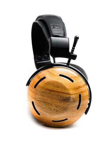

I agree, Emu has made some beautiful and great cup designs, materials and tuning. I was thinking of keeping it simple. Same cup dimensions as the current X00 then add vent holes like a ZMF closed back
Don’t forget, ZMF have ended up with a closed design without the vent holes for the VC that many prefer to the Eikon and Atticus. Might want to look into how they achieved what they did without the venting.
I thought the venting just moved to the ring of the cup instead of the face for the Verite. Think that’s what I’m seeing here
I was talking about the huge venting holes on the Eikon and Atticus and how ZMF was able to get away from them and have a much more closed design with much better isolation yet attain an even larger stage. There’s a lot going on with the VC design.
My point is… Simply chopping huge holes into your TR-X00 cups might not be the best solution. :slight_smile: But by all means, go ahead and try it. I’d enjoy seeing photos.
