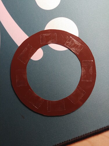

Another thing to note is the Eikon pads fit rather loosely on the Fostex headphones, so you’ll need embiggening rings.
To make these, you’ll need two Ovaltine tin lids, an exacto-knife, and some 1/2 inch double sided tape.
The outer diameter is 110mm.
The inner diameter is less important as long as it doesn’t cover the driver any. Mine are about 74mm.
Once you’ve cut it out, apply some tape like this.
And stick them on the mounting rings like this.
This will keep the Eikon pads mounted properly.
