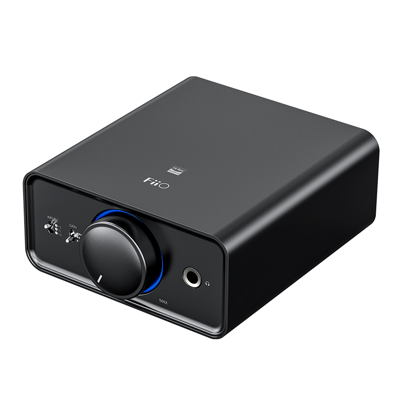

Almost impossible to get in Austria or German amazon.
There is the FiiO K5 Dock but no Pro version.
(Edit: There is only one seller for the fiio k5 pro for 130€ but I do not really know about that seller, never head about them, looks like audio only seller but I do not know)
There are other products from FiiO like the K3 or Q1 Mark II.
