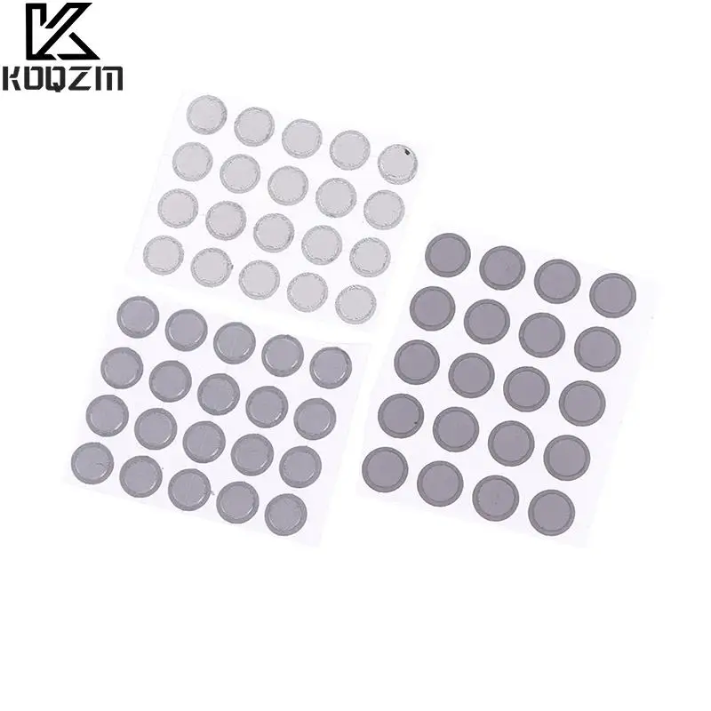

Also, has anyone had luck with a tape for the front vent? I used an Olina filter and it rubbed off in a couple of weeks
I use a Y3 tuning filter and it hasn’t come off yet:
Hmm interesting. How many hours have you put on since you added it? I also think part of my problem was that my Olinas sit pretty deep in my ear so my ear rubs the front vent. Im hoping I don’t need the front vent mod once I do the Tanya’s though
These have pretty good adhesives on them. As a rough rough estimate, 60-80hrs? I use almost every day, for a few hours per day. I have the Tanchjim filter mod + front vent mod. I tried to get the Olina to sound as close as possible to my O2, which seems to be the warmer variety, so I’ve done both mods.
I might have to check those out if my Olina ones fall off again
My front vent filters don’t last long either. Once you know you’ve got it right, it would be easy enough to secure with some clear nail polish etc. I haven’t tried but how difficult is it to get inside by removing the faux stone? Back side filter add would solve this. Replacement caps would be cool.
Huh, interesting. I just put some new ones on today (not because the old ones were detaching, but because I wanted to try no vent filter mod again), so I can tell you how long it lasts. Mind you, the old Y3 filters were still sticky and I needed to work a bit to detach it.

You could also buy some 4.5 mm 500 mesh filters as they are considered to be close enough, as far as I know.
thanks but do they also fix the condensation issue ?
I think your best bet to fix condensate issue is to get a metal mesh. they don’t get clogged as easy
Only heard from one trusted person saying that the Tanchjim filter helped resolve the condensation issue, so heed with a grain of salt.
So I got more filter values the other day. tried all the options and I’m staying with 250 over the stock filter and 250 over the vent. It was odd, I tried 200 over front vent and it sounded underdamped so instead of less bass, it just had less rhythmic bass and sounded more bloated. I really think 250 is the sweet spot for both. Like this, I absolutely prefer them to the oxygen I had but I likely had the low bass version so ymmv.
4.5mm 250 mesh
