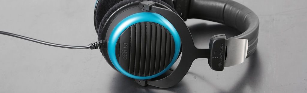

I think you will be just fine using one of the beyers then… tygr sounds superb on warzone but if your looking for perfect placements with the bright advantage… thats the 990 you want the liquid spark amp for that not the JDS… keep in mind you can use say a Liquid Spark amp with another brand of dac as long as you can connect the two with cabling… all you need is the DAC that can work with ps5

is it the regular 990s or 990 pro 250 ohm version? plus any brand rca cables would work correct? furthermore, what’s the difference between d10s or e30s? last question, what does switching from low gain to high gain back and forward do?

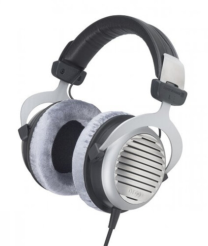

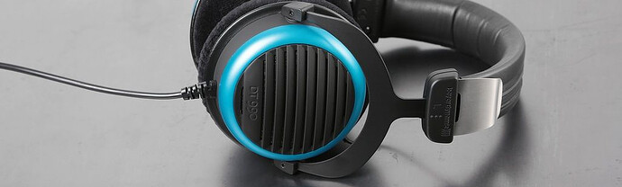

you want the ā€œeditionā€ it’s called they look like this
only the ā€œeditionā€ comes in 600 ohms the pro does not and the edition has the straight cable while the pro has the studio coiled cable.
Also, beyers can come in a wide variety of colors.. the all black version does have different pads though which are the same pads on the Tygr 300R if you prefer those.. I believe theres a chrome version floating around for the 990 as well..
and of course manufaktor variants only obtainable through special means or in europe
note: all colors are aesthetic only.. the sound stays the same unless you are comparing the silver to the black pads or the differences in the ohm changes. 600 ohm sounds the best by a good margin.
