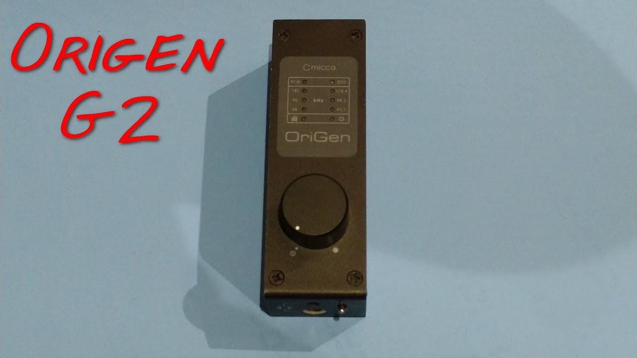

Origen 2
" OriGen functions as a USBto-S/PDIF transport and does not perform any signal decoding or volume control function."
https://www.amazon.com/gp/product/B07R8138XL/ref=ppx_yo_dt_b_asin_title_o05_s00?ie=UTF8&psc=1
It has an XMOS U8 chip handling your USB and it is pretty isolated for what you are looking for.
It was Plug N Play for me. It is what i got for when i get my Enog2 or need Optical out of my laptop since it doesn’t have it built in but i would not use SPDIF/TOSLINK from a laptop directly anyway.
