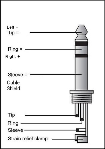

The common and logical way of wiring those is tip = signal, sleeve = ground. Any other pinout will be unconventional and provide no benefit. My guess is they were logical and did the reasonable thing, of course I might be wrong.

What they may have done is make it so they take a stereo 2.5/3.5 on each side. This way it does not matter how you plug it in. The left cup will only get the left signal (tip) and the right will only get the right signal (ring). I would not recommend trying a mono plug since the sleeve occupies the ring space and that could damage something I would imagine.
