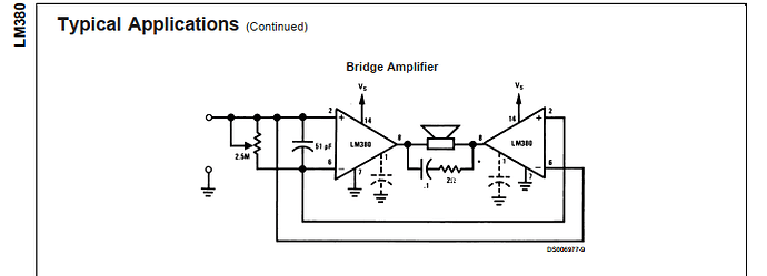

What iFi labels as “s-balanced” is in fact not balanced, but bridged amplification:
For reference, Bridged Amplifier configuration from the LM380’s datasheet:

In the Gryphon thread my picture about the S-balanced was not about that circuit itself but more just to have a drawing example if Sebastian can provide something similar about what connection the Ifi adapter makes. I kind of closed that topic for me that the ifi adapter only uses L+, R+ and “Ground”. The ground then is connected to the “-” of one of the two amp chips for each channel. The second amp chip does nothing
The 3.5mm female is a 4 pole? Like the hifiman 3.5mm balanced with L+, R+,L-, R- (TRRS)? I had one of those, if you plug a 3.5mm 3 pole in it you bridge the negative contacts. For me it was working as long as the music was mostly mono(same voltage on both channel) , when the stereo effect was bigger the amp ran into protection mode due to the bridged negative contacts. Don’t remember what amp I had at that time…
On a balanced circuit, circuit ground does not carry any signal. As such, connecting positive or negative to it would not complete any circuit resulting in no audio.
Knowing that and the fact the iFi adapter only uses “half the amplifier” means it can not be a balanced circuit but has to be a bridged amplifier that is also referenced to ground.
