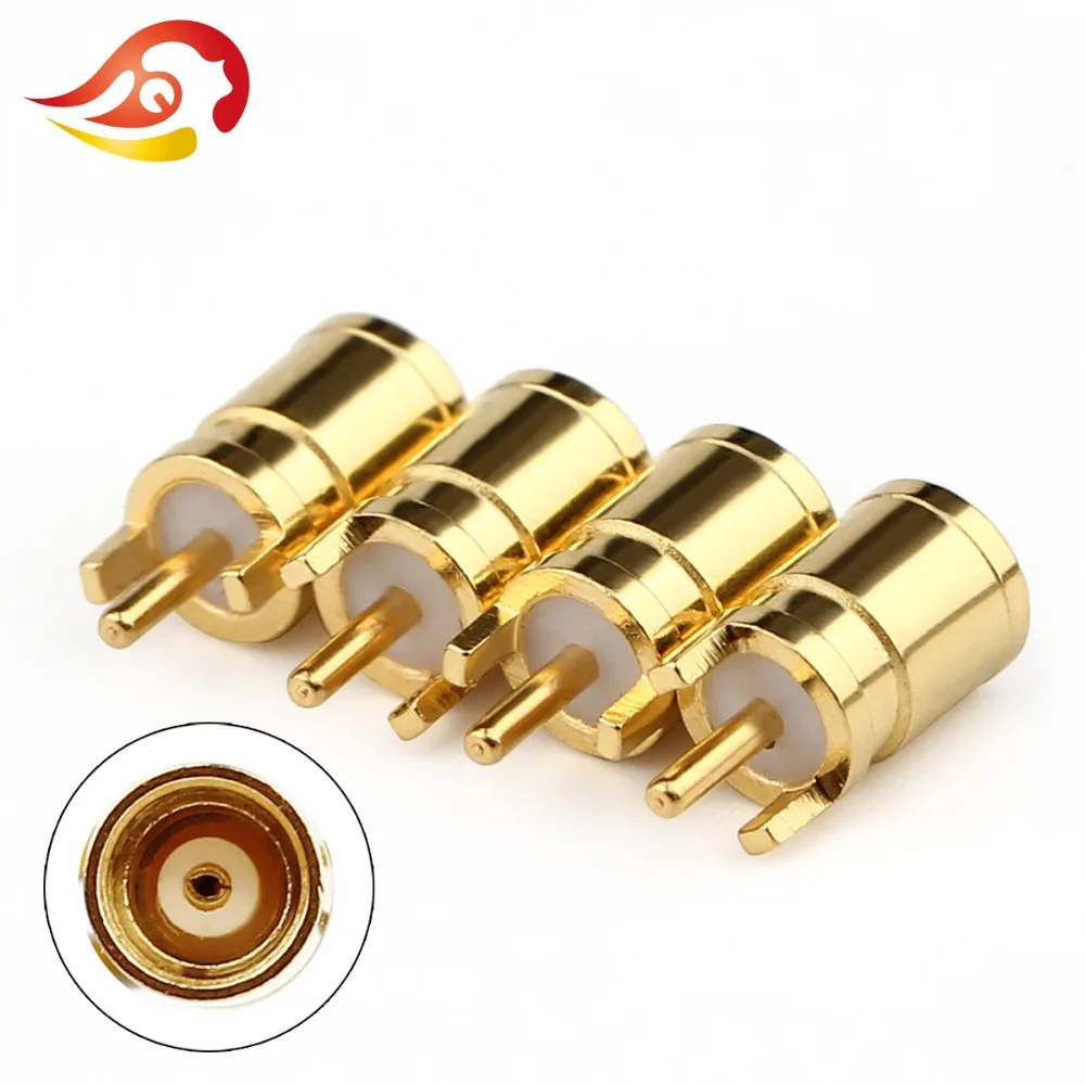

Guys my R mmcx is so loose that he barely connect . where can i find a mmcx female connector to replace it ?

does the Timeless’s male connector have this adjustable washer on it?
Yes 4 and i have expand them but still the same problem is a QC problem i got it loose from the beginning and now it getting looser . There is no other solution i need to find a new connector . thnx god it’s not a resin shell so there is hope :crossed_fingers:
:crossed_fingers: I guess you’ve tried another cable or even the lefthand mmcx on it?
Yes i have 3 mmcx cables always the same problem IMG_20211128_112411
I think the problem is in this thing its a bit deeper then the other side so the shaft can’t touch it well
Well in doubt Digi-Key has everything
I think i will try this
Hope it will work :crossed_fingers:
good luck. make sure it fits the timeless’ case if you haven’t already
I’m buying it based on this pic :laughing: @blanche
Haha you got this!
Definitely above my skill level, I guess :smiley:
Good luck!
Thanks to all of you guys :raised_hands: i will try my best to save my child
