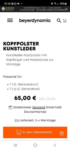

So yeah, to confirm prices on the T1’s headband seems to be universal between the 3 generations… The headband is not replaceable easily. Either a full creative modification is needed or you have to shell out $200-$375 to repair the headband. The cushion will obviously wear down and from the looks of mine which is now finally starting to give… the seams of the headphone seem pretty weak that holds the foam in. Got the price check from consolidated who does the repairs for beyer. Email response below incase you guys are wondering about potential repair yourself.
The head cushion is only replaceable as a complete unit with new ear cup yokes. That is part #916293 which costs $340 plus our labor of $35. However, I have some like new parts that I could sell you
for around $200. Let Me Know.
To initiate a non-warranty repair, please request a repair on our website.
Once your request is approved, you’ll receive an email with shipping instructions.
Please let us know if you have any questions.
This price honestly turns me away from the T1 quite hard… I love the headphone but that price is just… ridiculous. I don’t see why they can’t fix this… the 1990 has 4 screws that holds that headband into place… theres no reason why beyer can’t implement an easy way to fix this headphone yet failed to do so in the 3rd revision
So if we are talking T1 Gen2, the german beyerdynamic website lists the headband with the clamp things for 65€. No need to get the whole thing.
That’s rather odd, unsure how to go about feasibly unclamping the plastic without breaking it… assuming theres a lock mechanism but I am going to question consolidated on that part
Edit: I went ahead and sent them a questioning email. I see this same part but for the original T1 first gen on the US website but with a Contact Us button… the original T1 had real leather for its headband while the 2nd gen has leatherette material. Though I find it a bit irritating to get quoted well over $300 supposedly with only $35 labor yet on the EU website it clearly is not an all in one piece and its nowhere near that price point.
Curious if anybody knows how to unclamp the plastic pieces on the T1 without damage
I think the plastic pieces are just clipped together…seems like it. I guess they will break when opened.
Curious to see what they tell you. Such high part cost seem crazy…
That was my thought… almost $400 for just a headband? Thats about the cost of this thing on the used markets in mint condition these days its insane. It does look like youd have to break the plastic clamps to get it open and what not… but at this point… honestly if they are going to try to rip off those in the USA I would sooner just cut this headband off and thrown on one of the other headbands… its the same size as the other beyers after all. I will chime in later when they respond, more than likely with some bs reasoning. Obviously was lied to about it involving yokes in the order.
I just want to chime in here on the response. For the record, I did claim it was only the head cushion that has an issue and he tried to get me for that cost.
response was simply
I can just replace just the head cushion if everything else is intact and that part is only $82 on the 2nd gen plus the $35 labor.
So good news on that front i guess! i think 82$ is fine
beyer USA selling a used pair in ā€œgoodā€ condition of the ninja blacks for 500$
edit: looks like as of 8/14/21(when i posted this) they have 17 pairs.
And here i thought after banging my t1 headband and scuffing it that a replacement wouldnt be so bad. I was hoping the amiron headband would fit. I like that headband.
This solution doesnt look so bad i guess.
Yeah, from the looks of it since mine is coming off literally… it appears to be using some kinda of adhesive in the plastic clamp sliders that eventually just wears out. Absolutely awful design idea as its doomed to fail out. Honestly, $82 + $35 may be cheap but we can’t even just buy the headband padding here in the USA which is bothersome as I would prefer just to replace the padding myself… at that cost you can just save money and replace it with like the custom pro headband, amiron, whatever as all of them are roughly the same sizing.
