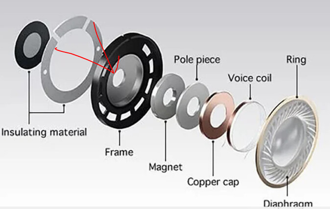

It looks like it is built into one of the 10mm DDs, kinda like a coaxial setup but INSIDE the other driver, so I would guess it is only being affected by this particular driver and not the other 2 DDs.
I assume that this 10mm driver isnt doing anything else than bass so the PR should work better here than the in shuoer model.
Makes no sense.
It says dual magnet structure but a PR doesn’t need or have a magnet and that drived behind pole piece is getting down force .
The main driver in “excursion” is pulling 2nd small shroud into same direction so how is is seperately vented to the ear?
That is a regular single magnet polepiece so the 10mm is dual mag? The "passive radiator is simply going over the spot filters are put on and …?
That is not an opposing driver. It will pull with the 10mm excursion and it won’t move because it has no surround and when the driver retracts instead of pushing mass through pole piece it is pushing on the paper filter with no surround so no real excursion?
I believe that where in a regular DD, this hole.
Is used for venting, but Binary instead of using it as a vent is placing another diaphragm on top of it.
I believe it is similar to how bluetooth speakers have their drivers angled.
But this looks like a regular diaphragm and not sure if it will do anything…But then again it does look similar to what akg did with the old k240 sextett.
Still curious on what the changes would be if they changed the diaphragm to like…tape or something (to still block the vent) and then graph it if it makes any difference…

If letshuoer had simply crossed 1 driver lows only and enclosed it with the PR it would actually be a PR.
The Quattro is not a PR.
Engineer at Letshuoer admitted it was an error to label it as a “Passive radiator” while Youtubers continued to pass off bad info, not subjective opinion but flat out bad labeling of tech.
That Quattro has a membrane instead of a filter behind the pole piece, :face_with_diagonal_mouth:
Me reading all the tech talks you guys are doing with the Dyna Quattro in my ears is fun. It’s like I am trying to relate the words you guys are typing and feeling the tech.
Yeah, all they needed to do was add a wall in between which they could have done via the faceplate and then have some holes for the wires.
Kinda like this I guess.
“Please note that PFM is not the same as PR, and do not share the same technical definition and the application is different. LETSHUOER PFM is a reverse of the working principle of passive radiator. It has a vent hole within the IEM acoustic chamber.”
Both DZ4 and S15 are using this thing they call “R-sonic Passive Filtering Module”.
Now I wonder: Did they try to do a PR, messed up, and now calling it something else to save face? Or was it actually never intended to be a PR?
