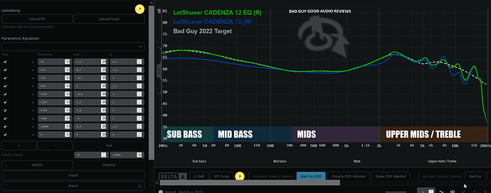

Without any scientific background and only speaking from my own experience there is zero degradation in sound quality when using EQ…the opposite is true for me…If you know what you are doing or at least know how to use the tools that help you with equalizing the sq only gets better.
Of course the drivers need to be of good quality and the changes in a reasonable frame.
Also you should use a negative preamp to avoid clipping.
I usually try out presets from www.autoeq.app or use the AutoEQ function on squiglink and then make some minor adjustments if needed.
In the most recent case i auto eq´d Cadenza12 to the HBB2022 target which is perfect for Hip Hop, Techno and as an allrounder for not so critical listening sessions, but for more gentle, clarity focused music and more critical listening i just lowered the bass by 2db…so simple, so effective
I tend to have two EQ profiles for the IEMs i own.
