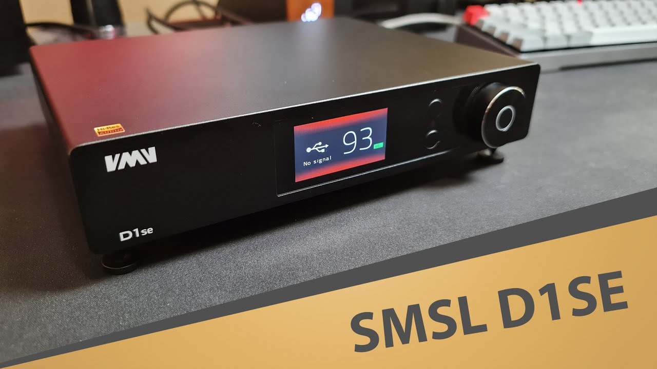

Received today my leaf cmd-17 with upgraded clocks, and my dac just show me : no signal message.
I tried to change hdmi cable, tried to install driver from manual, device is detected by windows, but dac shows - no signal:(
What should i do, to make it work?:frowning:
@Pokrog please assist
Coaxial connection works, but the sound quality is weak, direct connetction to D1se - usb sounds much better then this converter board. At the moment - this purchase, a big disappointment :frowning: Because from the exit i2s for which I bought it - there is no signal.
Trying to find how to make i2s - work

But what about the converter device? D1SE and Leaf audio CMD-17 converter did not work at all? But from the pin scheme and dac manual they should work without an issue, maybe converter is faulty?
I’m not sure, maybe D1se should be adjusted in the menu somehow, but inversing channels didn’t help my unit. Anyway, if you’ll make it work, please let me know. I’ve ordered another power cable for U2 pro and if that won’t help I’ll ask SMSL if they know something that can help
I don’t know if my U2 pro is working or not, because I have only hdmi cables to check
I tried to swap usb cables, hdmi cables, i putchased linear power supply for this converter, and just no signal on the dac side:( i don’t have solution for this, just wasted my money for all this items: ddc with upgraded clocks, power suply and fancy cable for this… Looks like i naive fool:(
Don’t be so negative about this. LPSU is quite useful and can improve a lot of audio equipment, especially if you can regulate voltage. My zen dac became 5% better with LPSU. As for CMD-17… I don’t know what I would do in your place. Try to contact SMSL and return your reclocker if they won’t help. Hope you still can return it. Also @Pokrog might help, he is more experienced with DDCs
I’m not negative, but currently im talking to D1se seller and to Converter seller, and they approved that this pin connection scheme should be supported without an issue, but it does not work. I will try to return the converter… I tried all available to me options, smsl via Shenzhenaudio store confirmed that this scheme should be supported, and still no signal.

So I had the D1se for a bit and had the same issue of it not working. But… I recently watched a review by GoldenSound where he mentions changing the DPLL (which reduces the level of jitter) in the menu options. He says if it is to low it might be dropping the I2s connection or not connecting at all. I didn’t know about trying this until after I returned the unit. You might want to give that a try and see if it helps.
I added the video link below
that’s a pretty cool feature. it definitely sounds like the problem he’s having.
Thank you guys, but im sad to say that i already tested that feature, but i will do it again.
Just checked - not fixed the issue
Here is the response from the seller, they are asking to send D1SE back. Looks like all D1se has hardware problem with i2s interface:(
