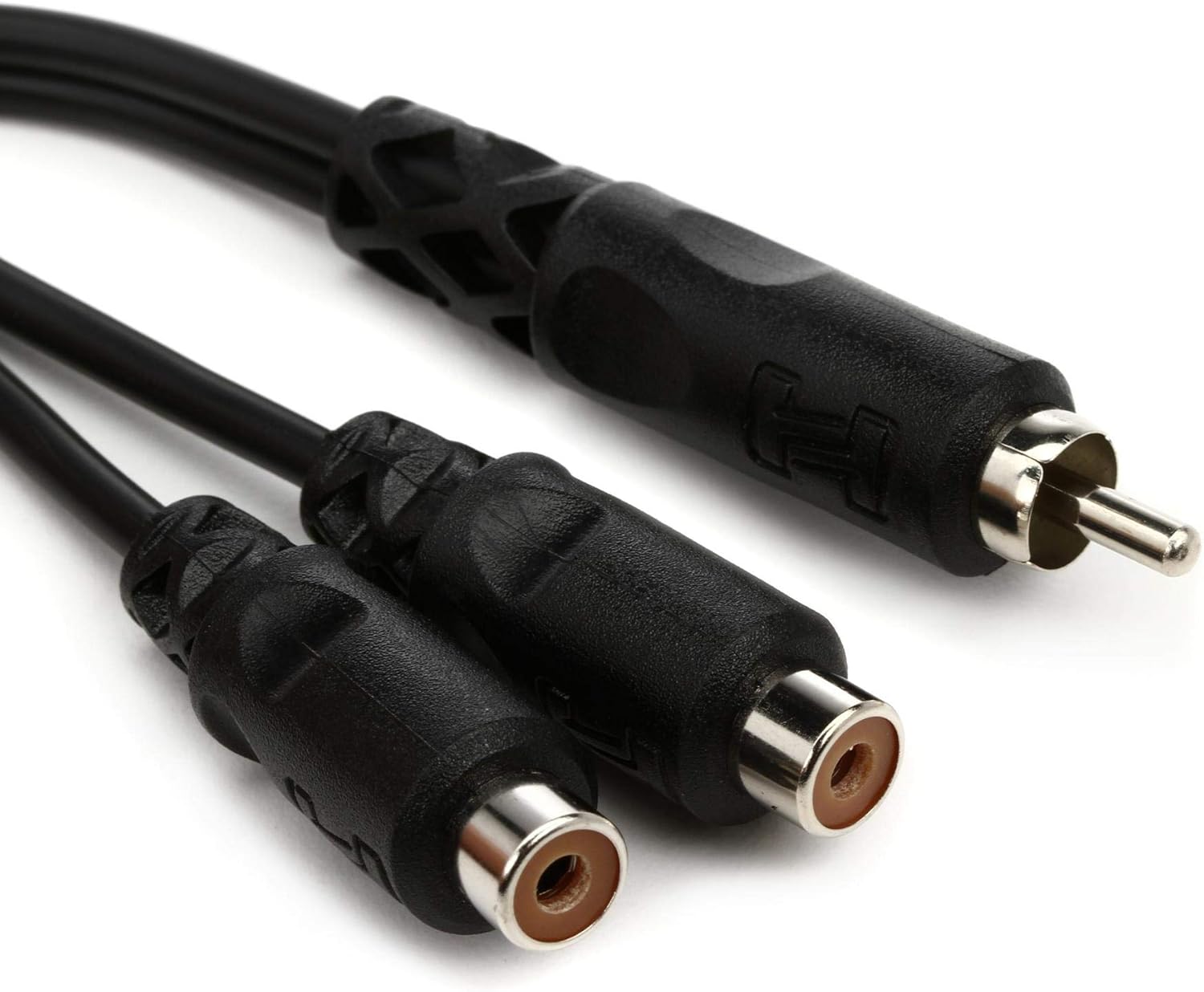

Yeah you could no problem, you would just want an rca splitter. That being said I think now you might want to instead just split from the passthrough on the thx so you don’t have double volume control
So it would go 789 pass, to splitter, with one going to atom and powered speakers, and the other side going to the emotiva
Ah, duly noted, makes sense. Thanks!
That way you can avoid the double volume control issue with the atom too and it is just a cleaner option overall
Just grab two of these and you are good to go :+1:
Cool, thanks for the link. I was getting confused by some of the listed products when I searched.
https://www.amazon.com/Mediabridge-ULTRA-RCA-Y-Adapter-Inches/dp/B005DL2OVE/ref=sr_1_10?keywords=rca+splitter&qid=1579127019&sr=8-10
https://www.amazon.com/OCR-Female-Speaker-Splitter-Adapter/dp/B0159MA936/ref=sr_1_13?keywords=rca+splitter&qid=1579127019&sr=8-13
Don’t understand why it’s color coded red/white when you’d be splitting the red and white separately, if that makes sense. Unless there’s some other use.
So the first one is for a subwoofer with a single jack input, so it takes the left and right and combines them for a LFE input

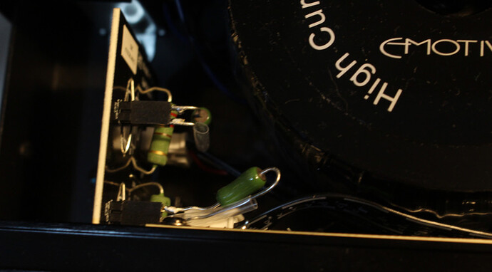

Disclaimer: This is an unsupported modification that may break your headphones or the amp! You do this at your own risk.
I don’t think I ever posted a proper picture of what I did:

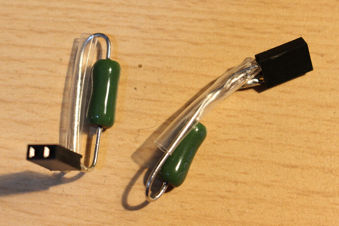

Parts:
2x 2.54mm 2-pole pin Like this one
2x Vishay G200-series 220 Ohm (220 Ohm, glas covered wire-wound resistor, the important part is >3 W rating)
Cost: ~1€ or $1
I put a piece of heatshrink over the free leg. They are bent like this to prevent them making contact with anything in the amp.
This is them installed. As you can see, the 90° bend avoids hitting the transformer, the ā€œoff angleā€ one avoids the front circuit board.
You may rightfully ask yourself: WHY would you do this?
Simple answer: More power without all the noise, this is a speaker amp first, headphone amp second.
This mod (wich you can just unplug any time or replace with the supplied jumpers) lowers the output resistance to 110 Ohm (instead of 220 Ohm or ~0).
How much of a risk is there in doing this?
Very little.
You could still short out something on the front circuit board (the one between transformer and front panel).
Ergo, just be mindful of what stuff is touching what, and you will be fine.
