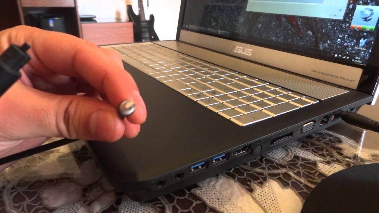

Will this cable work with the Enog2 pro? This text makes me think it won’t.
The bigger optical end will fit in the enog2…what is the other side going to?
The 3.5mm jack on my laptop which I believe should have a S/PDIF-Out as it asks me if I want Headphone, Speaker Out, or S/PDIF-Out when I plug anything into it. If for some reason it doesn’t work, I’ll just return it and use my topping d10 to convert Usb to S/PDIF and get a Toslink to Toslink cable.
I was just confused as to why it’s mentioning the cable can’t convert digital into analog and whether that meant anything to me with trying to use it on a dac.
if your laptop is able to send a digital signal out with the cable, im assuming that would work? someone with more experience could chime in though haha found this video:
I checked some reviews and found people using it for an external dac from their mac, so I’m going to go ahead and get it to try out.
