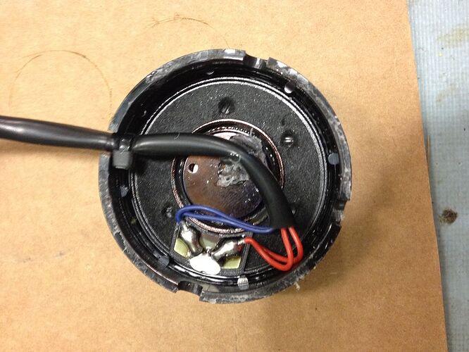

I personally prefer the dynamat mod. You have to open up the cupsā¦best way to do this is by using a hairdryer and applying heat evenly around the area where the cups are hot glued together. It takes about 2 to 3 minutes of heat for the glue to soften up, then you pull apart. You apply a dime sized amount of dynamat (or even blue tack) to the rear of driver. You also want to keep the 2 pin sized holes openā¦never seal these.
The other mod some people choose to do is poking holes in the driver paper (no more than 2 to 4 holes) for extended bass. With the sr series changing from i to e, Grado re-tuned the drivers by adding 4 holes stock, so this mod isnt as popular anymore. However, if you want more bass, this still works. Keep in mind this one is irreversible, so starting off with 2 holes and working your way up is recommended. In the picture below, you can see where someone used a ball point pen to poke holes in the driver damping paper.

This is great! And that custom set is beautiful by the way. What does the dynamat mod achieve? I had heard about adding the holes, but I hadnāt heard of this one before.
The dynamat mod helps to eliminate metallic type sounding resonance and vibration within the driver. It helps make the treble sound less grainy.
What glue do you use to put it back together? If I do it I would like to be able to open it up again fairly easy so I figure that rules out something like super glue.

You can reheat the glue to use it againā¦or if you have a hot glue gun, you can apply a new layer. Iāve also heard of people using rubber cementā¦but that can get messy.
