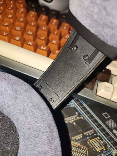

Update on my ERIS, after having opened them several times to increasingly try fixing the rattle, no amount of tape nor twisting would resolve it. The more I focused on it, the more I was convinced it was something loose that could roll back and forth. Frustration set in. So after dismantling the headband (incorrectly, but I got there) I found there is a ball bearing that engages for the sizing detents. I figured it came loose somehow, so I reseated it, put them back together, didn’t tighten the screws down too much so as not to risk stripping the plastic. Still rattling. Tightened the second set of screws in the headband a bit more. Gone. No more rattle! And as a bonus the ratchet is much more firm. So I figure when the band stretched onto my noggin, it loosened off the ball bearing enough for it to roll in the slot.
The topmost screws (flanked by the slots) are the ones that needed to be snugged down, for reference:
