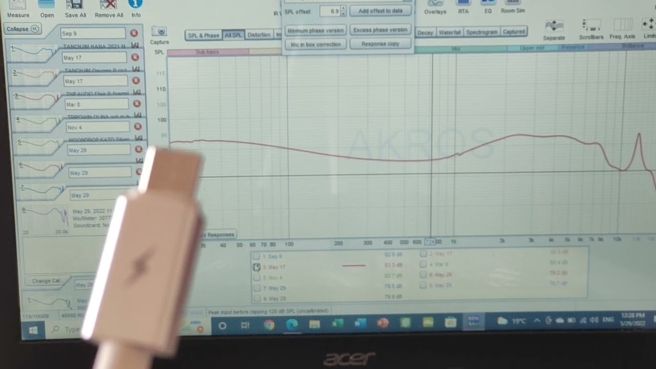

Wondering if anyone in here could help me out? Having been through a boat load of IEMs I’ve finally come to what are easily my favorite four. I’ve graphed them here.
My issue is I’m trying to identify what it might be about them. I know charts don’t tell the whole story. I just can’t help but look at the four and see some similarities. Most apparent in the 5k-8k range. With a similar lift at the 10k. Which treble is usually the main issue that turns me away from what might otherwise be great IEMs.
I’m thinking that this is the key area that decides if I like an IEM. Question is what is in this region and how would it effect the tuning? Just looking for general thoughts that can help steer me for future purchases. Most notably because I’m eyeing the Vulkan, when it’s released, just noticed it has more a peak in the areas mentioned. Worried it might not be a good pairing for me. Any thoughts are greatly appreciated.
That’s a similar dip to the Serials and I remember in HBBs video for the serial he says that’s an upper harmonic cut so maybe you enjoy that depression? They all look to have relatively mild treble energy with decent extension. The mids and bass actually look similar as well minus the Moonlight.
Outside of that I got nothing haha
A lot of it depends on what your hearing can and can’t reproduce. For example, I listened to a sine sweep and I struggle to hear anything much above 11k without turning the volume up to dangerous levels. I’ve learned my biggest sensitivities for treble are between 4-8k but also that anything around or above the Harmam curve from 2-5k is too much energy for me to find pleasant if the bass/lower mids aren’t a little boosted to compensate (bass alone can’t make more treble tolerable. So I can stand for a 1-2.5db boost in the mids from 500-1k for more weight (and to balance out more amounts of treble in general). But it sounds like your preference is similar to mine but an even more pronounced sensitivity from 4-8k
