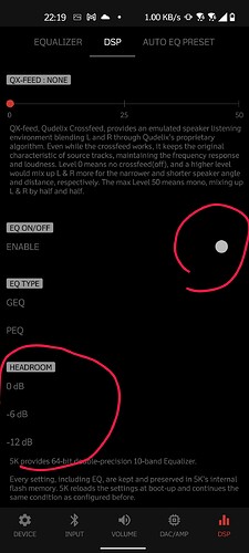

All are crazy high, either you have some stupid EU loudness limit set in Android or preamp setting on for couble of dB in EQ. I have mine fluctuating between 40mV and 110mV for the least sensitive IEMs.

Sorry, I am Windows user and I generally operate in 8-15/100 for direct driving of IEMs. Did you check if you have EQ enabled under DSP section with some headroom setting on?
no DSP and no artificial limit on my phone or computer. running straight through the computer and I am at 7-9/16. I think I just listen to music a lot louder than everyone else. What is weird is that I don’t listen to anything else loud and Im usually sensitive to loud noises IRL
