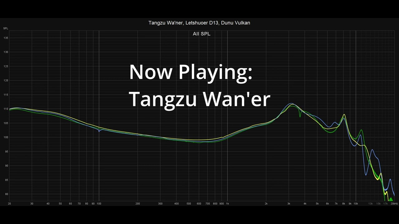

Prepare to get your mind blown or not.
This demo demonstrates how three different IEMs sound when they are EQed to the same target frequency response curve.
For this I used the AutoEQ function that can be found on the squig.link sites.
My process was like this:
  • Apply AutoEQ on the Tangzu Wa’ner, Letshuoer D13 an Dunu Vulkan against the Softears Target which can be found here https://harpo.squig.link/
  • Export the AutoEQ settings
  • Import the AutoEQ into APO/Peace
  • Measure FR graphs with my 711 coupler
  • Repeatedly fine adjust the Peace PEQ and measure until all 3 FR graphs align as close as possible
  • Record sound demo with the miniEARS DSP of each IEM and normalize to -1 dB headroom
Findings:
  • Transducer quality matters (duh, call me Captain Obvious)
  • FR graphs don’t convey sound properties (duh, call me Colonel Obvious)
  • Perceived/Personal Sound quality can be improved by EQ
  • FR graphs are more like the description of a meal but don’t tell how this meal is prepared or what the ingredients are
  • BAs respond better or more incisive to eq
  • Even while measuring the same I could better sense the huge 13mm DD in the D13
