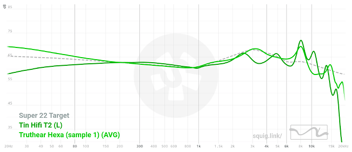

Not too irrelevant, but it was q question with a lot of not very popular (at least in this forum) sets in the mix :slight_smile: You do want direct upgrade over T2? Are you considering FiiO FF5 earbud and not FH5? It is quite different experience than any IEM. Also A4000 has veeery different tuning to T2.
I believe Hexa would be the closest out of what have you mentioned.

You do want direct upgrade over T2?----yes keeping the near about same sound signature. (dd+ba/ dd/all ba)
Are you considering FiiO FF5 earbud and not FH5…yes ff5 earbud.
Also A4000 has veeery different tuning to T2…oh sorry idk that.

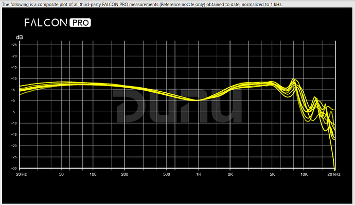

The following is a composite plot of all third-party FALCON PRO measurements

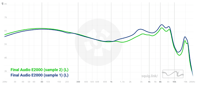

And, sorry, one final point I’d like to add on this particular topic is that we already know that QC is problematic thanks to communities such as thing one in particular when measuring multiple IEMs of the same model on the same rig thus making the measurement rig an INDEPENDENT variable:
So, lastly, I would just like to say to those blaming the measuring rig, which I honestly don’t see much in this particular community, I find it to be in bad faith so as to detract from the fact that we already KNOW QC of unit variance is a problem among IEMs!
