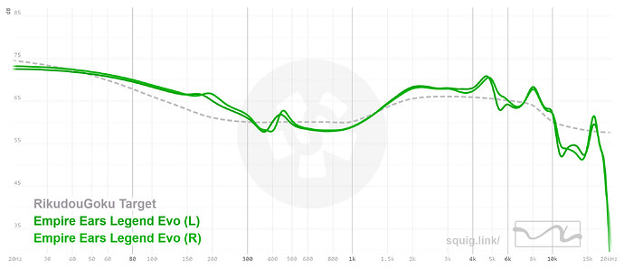

I see your doscinco and raise you a giant 8k peak. For the bold and/or insensitive:
Vulkan alone lined up at 500Hz. All 3 lined up at 300Hz
Interesting how the STORM has a huge divot at 8k rather than a peak…
that bass shelf of EVO does not look quite right
Nah it’s fine unless you’re blasting them, even then they scale pretty great. The cymbals are so crispy, nuanced, and airy.
@SoundEater good qc
@Rinderkappajoe Ya I think mine’s missing some sub-bass lol
I suppose that´s because of the foam tips. Did you try silicone?
Legend Evo and missing sub-bass is a meme :rofl:
ouch.
QC is terrible for something that costs 3k!
Should I be happy that there’s no scoop lol
That BC is probably working in the 200-500hz area. so no way it would have a scoop. Question is how good and noticeable that BC is…hopefully better than my experience with the Konoka.
Oh ya it’s definitely noticeable, the driver flex is insane lol
The worst I’ve heard in any IEM period :joy:
Are those vents? Looks like it only has those. Guess they wanted that pressure to help give you a better seal to help the BC perception.
Loki has more bass to compensate.
