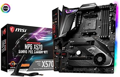

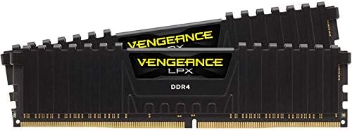

Gonna be upgrading my PC and I’m not very knowledgable. I’m thinking of getting these, does it check out?

The mobo might not be compatible? AMD 5 3600s are X570 not B450 iirc <---- nvm, it ‘works’. If you’re looking for longevity and performance I’d go with X570 chipset though.
For the X570 boards the best cheap option that I could find is the MSI X570 Gaming Plus (with or without wifi). That’s what I currently run with my AMD 5 3600 and I’ve had no issues.
The RAM should be fine.

I had the same choice to make when I built my 3600x and I ended up going with x570 as well.
If you do any future upgrades, it supports PCI-e 4.0. Up to you, but you’ll reach the limit of x450 even though it is technically compatible.

The gigabyte b450 board caught my eye cause it has spdif which a lot don’t seem to have.
GPU should be fine unless you wanna play games on high graphics. I could sell you a used MSI GTX 1070 if you want for dirt cheap :stuck_out_tongue:
The MSI board has optical (which I’m using). Idk about the other MSI boards, but I think they all have optical at the very least.
Invest in the mobo. RAM is always easily switchable. If you have to lose anywhere, go with slower or smaller RAM.
Hmm, very interesting. I’m down to get the x570, it seems to be a $100 jump for just the wifi? Or are there more features I’m missing? As much as I would like wifi/bluetooth it doesn’t seem very worth lol
