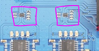

@Finite this is how Topping “fixed” the grounding issue:
That is a 5ct pogo pin. Better than sandwiching a wire in the case, worse than adding a screwed connection to the case.

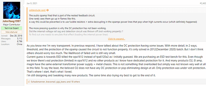

This is not a QC failure, this is systematic R&D oversight or negligence. If you can’t test for ESD resilience in house, then pay someone to test it for you!
If your protection circuit is known to be dysfunctional, then WHY would that “protection” make it to market?
That “JohnYang”-guy works for Topping.
Him talking about missing protection in other amps is semi-true. Schiit Audio (who has a fuse in all their amps to prevent a fault like the one in the L30 from burning your house down) will however replace headphones their amplifiers damage, the JDS Labs Atom has DC-offset protection built into its output buffers (I think the EL-Amp uses the same configuration, would have to check though).

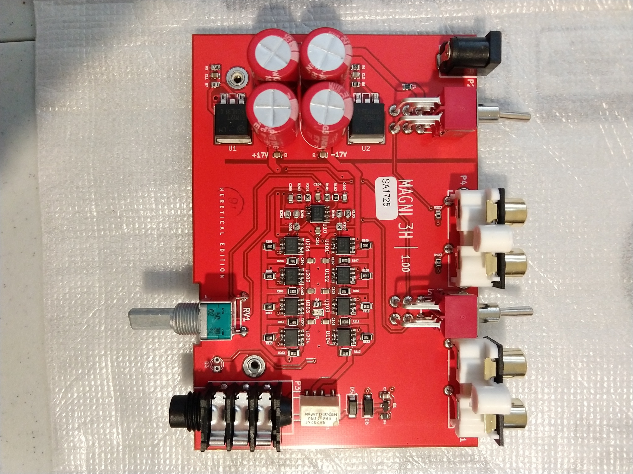

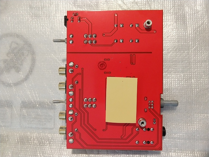

Edit: Anyone got a photo of the underside of the heresey’s PCB?
The topping fails were caused by lack of esd protection and that’s been solved, you’re the one making it tribal focusing on them like they’re the only ones that can have faulty units, and recommending other amps like you know sh*t about their reliability
Photos of both sides of the Heresy PCB from my unit. Not sure what the foam tan pad is used for.
